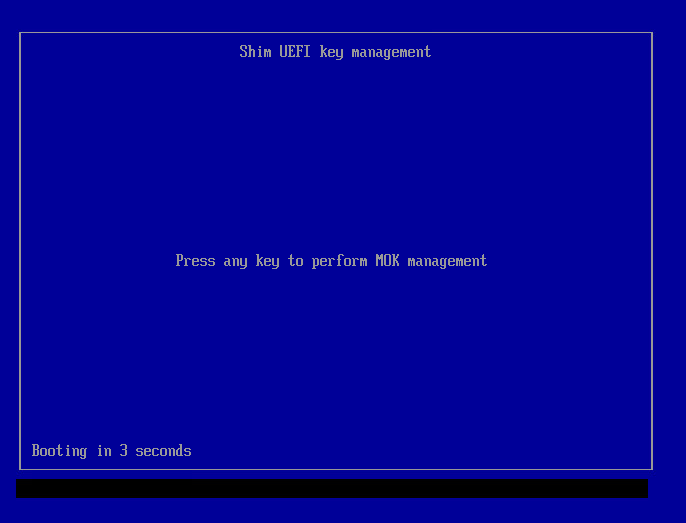

8 MOK Manager EFI interface.
At boot, you'll see the MOK Manager EFI interface:
SHIM UEFI key management

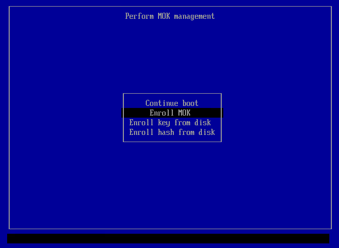

9 Press any key to enter it, then select "Enroll MOK":
Perform MOK management

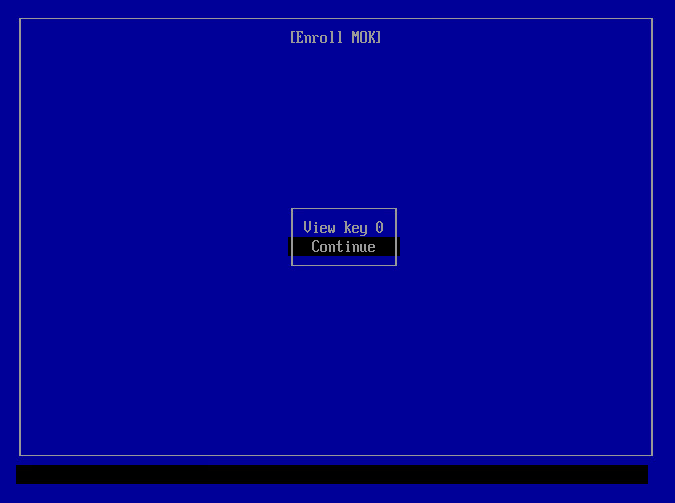

10 Then select "Continue":
Enroll MOK

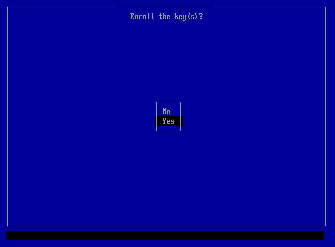

11 Confirm with "Yes" when prompted:
Enroll the key(s)?

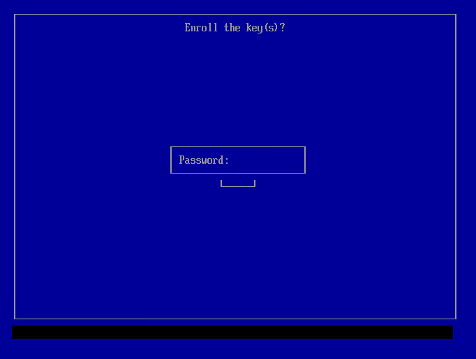

12 After this, enter the password you set up in step 6:
Enroll the key(s)?

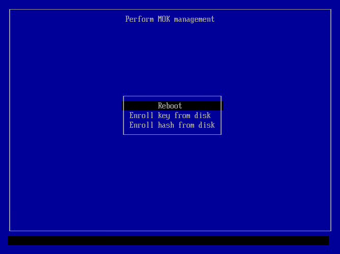

13 At this point, you are done. Select "Reboot" and the computer will reboot, trusting the key for your modules:
